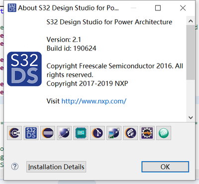

petervlna
Which version of S32DS for power have you used?
Peter
2,353 Views
asua
2,349 Views
petervlna
Then the issue is that you are running 'MPC5746R_PinToggleStationery_S32DS_Power_2017.R1
SW on the S32DS v2.1 which is not compatible.
Please use the embedded examples in S32DS v2.1 instead.
Peter

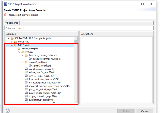

asua
Hi, Peter
So what does the RTM mean in the directory 'SDK PA RTM v3.0.0 Example Projects'?
What is the difference between the examples in this directory  and  in the directory of ' S32DS Example Projects'?
Thank you very much
asua
2,336 Views
petervlna
RTM - release to market
different drivers types. SDK and bare metal.
