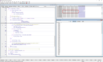

I am using MPC5748G dev kit and I tried running EEPROM emulator "demo" program in the S32DS for power architecture. I changed the size to 40. But when ever I am trying to write to the EEPROM more than 10 characters it is only writing up to 10 characters. I tried reading it back, but in the buffer I can only see 10 characters. Please help me in this regard.

I did quick test on my side and it works as expected. I just changed the size like this:
And that's the only change I did in the project.

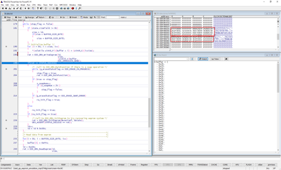

Then I confirmed first record is programmed as expected:
Second one is also OK:

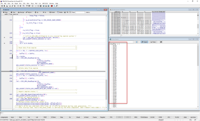

This is state of cleared buffer after programming of all records and before reading of a record with id 10:
And finally, I can see that the record is read as expected:
So, I can see no problem here.
