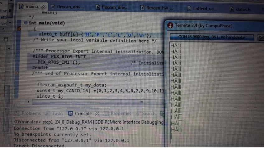

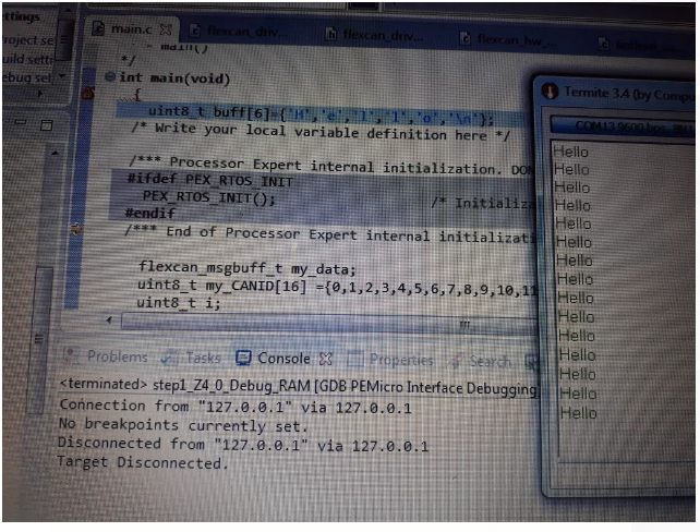

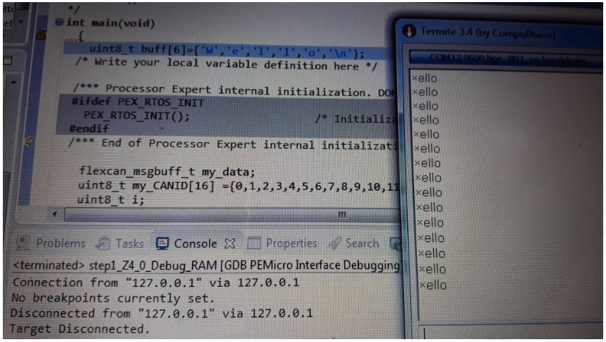

in connection with the above question; there are some more issues i am facing as attached in the snap shots, i am using FlexLin_device-2 for UART which is basically a USB port (Pin no. PC9 Rx and PC8 Tx).
I am trying to print "hello" on the termite monitor it is printing as "eello", and if i try "wello" it is printing "xello", if I try to pass as "Hello", it is working perfect where as if i try for "HELLO" is is printing as "HAlll", what is problem where could be issue ?

martin_kovar
this is known issue, which is caused by OpenSDA firmware. We have already sent many notices to PeMicro, who is owner of the firmware, but they have not been able to fix this so far.
The best solution is used another UART as Jed F mentioned below.
Martin
