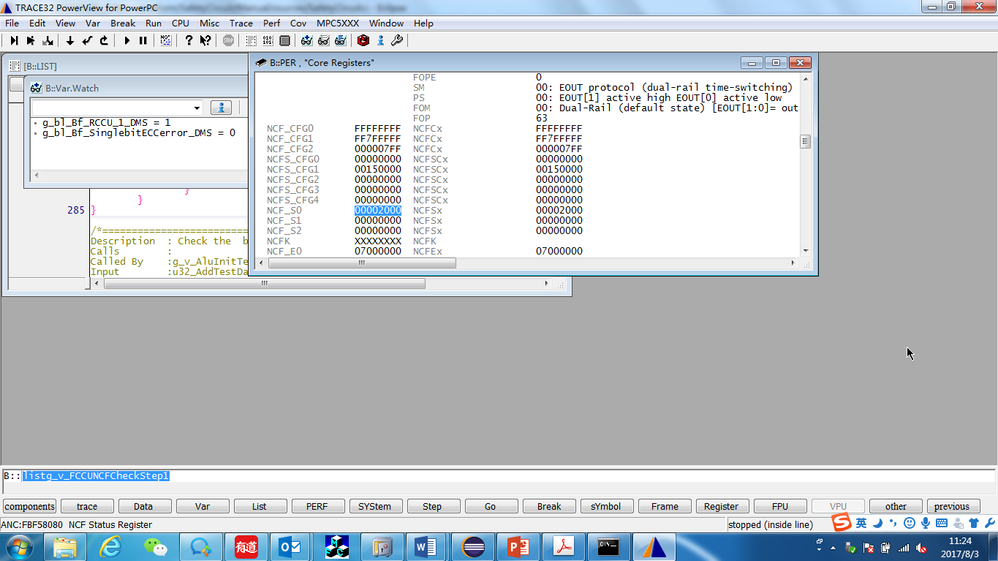

I failed to inject the document in accordance with the document MPC5744P_1b + 2b_flash_flash_by_utest_area_read-v0_0-ghs614, but the results were not correct.The results are shown as g_bl_Bf_SinglebitECCerror_DMS = 0, g_bl_Bf_RCCU_1_DMS = 1.I don't know what's wrong.Looking forward to your reply

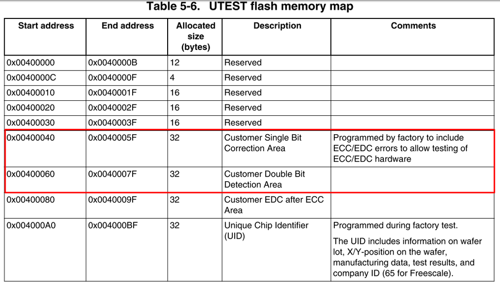

To inject ECC fault on this processor is quite simple.
Just read UTEST flash area, there is already programmed ECC single and double bit error.
Peter

liujinhang
void Inject_2bit_FLASH_ECC_error_by_UTEST_read(void)
    register uint32_t test_read = 0;
    // ECC is checked and non-correctable error found
    test_read = *(unsigned int*)0x00400060;
void Inject_1bit_FLASH_ECC_error_by_UTEST_read(void)
    /* Enable single bit ECC error reporting in flash controller */
    // Enable UTest mode
    C55FMC.UT0.R = 0xF9F99999;
    // Enable single bit error correction
    C55FMC.UT0.B.SBCE = 1;
    // Finish the UTest mode by writing UT0[UTE] with 0.
    C55FMC.UT0.B.UTE = 0;
    test_read = *(unsigned int*)0x00400040;
I have read UTEST flash area;and then,I added the above program, and then observed the result in the figure above, g_bl_Bf_SinglebitECCerror_DMS = 0, g_bl_Bf_RCCU_1_DMS = 1.I don't know what's wrong
