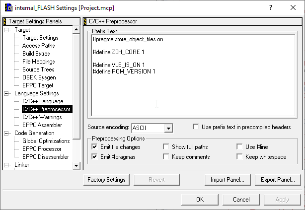

      When I use CodeWarrior2.1 to compile code programs, I only get .mcp project files, but I need the .obj file of the code program. I can't find a way or related settings in CodeWarrior2.1 to automatically generate .obj files, so please help me solve the problem of how to use CodeWarrior2.1 to generate .obj files. Thank you!

you may find helpful this thread - https://community.nxp.com/t5/CodeWarrior-for-QorIQ/Where-s-the-Object-Code/m-p/125154
Object files you can find in Project\Project_Data\internal_FLASH\ObjectCode\ folder.

jiachunyu
Thank you jiri_Kral
         I have finally generated the.o file with codewarrior2.1, thank you very much for your help.
