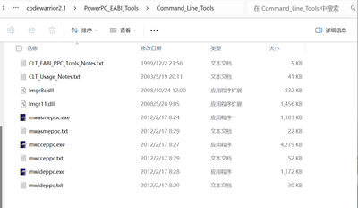

      When I use CodeWarrior2.1 to compile code programs, I only get .mcp project files, but I need the .obj file of the code program. I can't find a way or related settings in CodeWarrior2.1 to automatically generate .obj files, so please help me solve the problem of how to use CodeWarrior2.1 to generate .obj files. Thank you!
      I found articles and materials on the Internet plus about using the codemarrior2.1 command line tool (CLT), but I don't know how to use the CLT. My CLT won't open. I've set compatibility and selected windows7 for compatibility. My computer system is windows11, but it didn't solve the problem of not opening the CLT. So please help me solve the problem I encountered. Thank you.

jiri_kral
you may find helpful this thread - https://community.nxp.com/t5/CodeWarrior-for-QorIQ/Where-s-the-Object-Code/m-p/125154
Object files you can find in Project\Project_Data\internal_FLASH\ObjectCode\ folder.

jiachunyu
Thank you jiri_Kral
         I have finally generated the.o file with codewarrior2.1, thank you very much for your help.
         I would like to ask if in addition to generating.o files when compiling a program with codewarrior2.1, can other files generated during compilation also be saved in the project folder?

jiachunyu
Hi jiri_kral
Let me explain the project I am doing, we have finished writing the underlying program source code on codewarrior2.1, and then we need to convert the source code.c file to.o file, because of the protection of intellectual property rights, our source code.c file is not open to customers, we only provide.o file to customers. We have reserved the interface and function of the relevant function, and the customer only needs to write the upper level program code to communicate with our underlying program. Therefore, the client can only compile through the.o file provided by us when compiling, but it is not clear whether codewarrior2.1 can meet such requirements, so I need your help. If you have questions about my description, I will be ready to explain to you where my description is unclear. Thank you for your help. Thank you very much!

jiri_kral
I'm afraid that there is no such feature and CW v2.1 is unmaintained product. I'm not sure what you mean by .s file. If Motorola s-record - it is generated by default. into output folder.
