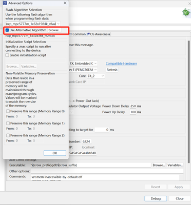

Now I need to burn HSM twice to complete the burning work. I want to burn HSM data and code script together at one time. Can I do this?
1,572件の閲覧回数
petervlna
I expect you are not using any advance debugger nor IDE.

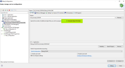

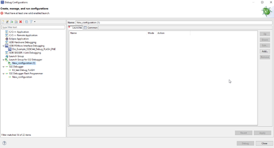

So for S32DS you will simply add another binary to be programmed:
In launch group
add additional object file
Or you can simply use Lauterbach TRACE32 where you will simple add another binary/elf in your programming script.

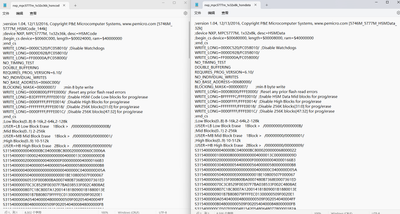

I actually want to synthesize a HEX file S32DS
Can the S32DS be burned?
Can data and code text be combined into one text, if possible?
