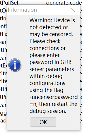

When I debug the MPC5742p mcu,The following error message pops up。Is the mcu secure?And
how I can  unsecure it? IDE is S32 Design Studio for Power Architecture Version 2.1.

One more thing you can try:
[peter] - You have to apply workaround:
1. run debug session
2. wait for message that there is reset escalation
3. disconnect J13 jumper (see screenshot)
4. click on OK and simultaneously put jumper J13 back
Do this few times and you will recover from this state.

First of all ,Thanks for your answer。I'm not sure if others programmed censorship DCF records.This ECU is used by others before I get it。The people who used him before can no longer be contacted。Is there some ways to unsecured the device?

Well, if the device is really secured. then without valid password you can trow it to waste bin.
check reset line on chip, if it is always low.

The device is only secured if you programmed censorship DCF records.
Did you programmed them?
