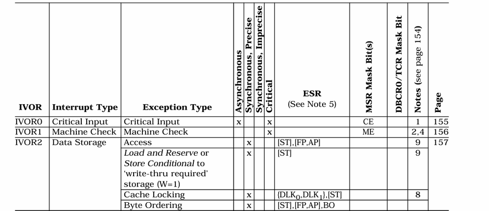

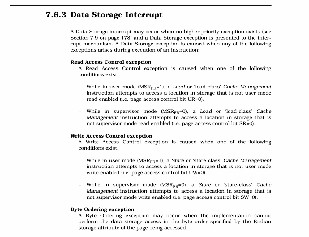

According to the documentation, store operations such as dcba[e] and dcbz[e] are not permitted on certain memory pages when MSRPR=1.
When such an operation is attempted, it is expected to trigger a Data Storage Interrupt due to a Write Access Control Exception but it is not Triggering.
I want to know the exact steps to intentionally trigger this exception for testing and debugging purposes.

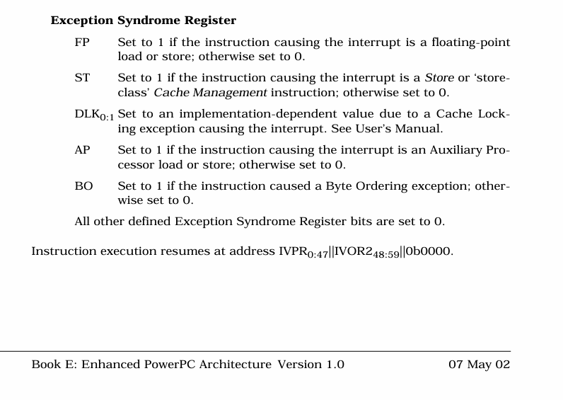

I have followed the test procedure as outlined and have attached the relevant screenshots for reference. Please review them still If you need a more detailed explanation, let me know

OK, these are screenshoots from manual. I wanted to see specific setup as you have.
