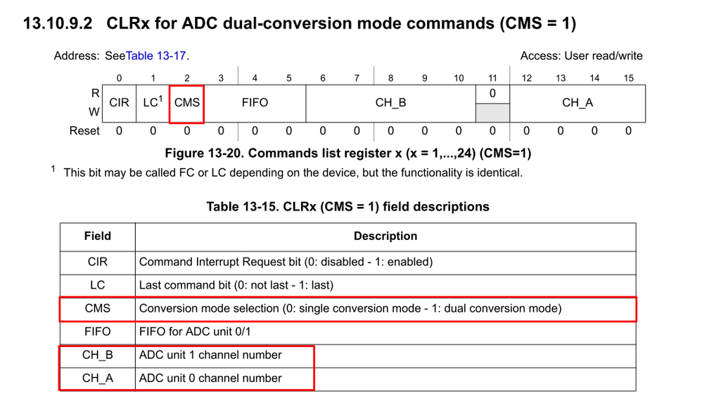

How can i initial the TCU?Is there any SW DEMO?

I expect you are referring to CTU and not TCU as you are speaking about ADC command list.
Here is the explanation:
Select CMS and Channels which have to be converted in dual-conversion mode.
Make sure your ADC's are in CTU mode.
Peter

Thank you for your help,Pete.The datasheet(MPC5744PRM.pdf) is hard to read.
