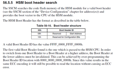

The issue is that I managed to enable HSM through DCF record and I verified it has been enabled through SSCM_UOPS_HSE = 1
But for HADR (HSM start address), SSCM_HSA_HADR = 0x00000000 which means that no HSM boot header available.
So I'm doubting that there's a HSM firmware flashed on my target.
Q1: How can I verify that my devkit has HSM firmware available?
Q2: what should I see in the following HSM code/Data blocks if I already have HSM firmware?
Q3: In case of there's no firmware flashed on my targets, How can I get the firmware?
Specially that I already have more than 100pcs
Q4: In case of there's firmware available, where can I find HSM start address ?

Hi @Yousry
Please notice that devices with HSM firmware are provided only to approved customers (for very large quantities). Standard devices SPC5748G... do not have HSM firmware installed. Devices with HSE firmware have special part number.
If you already don't have an agreement with NXP sales to get such devices, there's very low chance to get it.
It’s highly recommended to select a device with HSE (Hardware Security Engine). HSE firmware is freely available for all users. S32K3 family of devices is recommended as a replacement for MPC5748G:

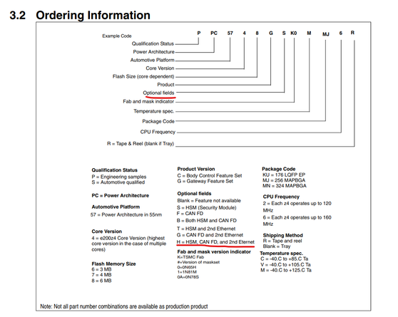

We already Ordered the SPC5748GHMKU6
which is mentioned in the reference manual "Order Information" section as it already has HSM
So would you guide me to figure it out through answering the questions I asked before ?

I have to agree that the datasheet is confusing. I asked to clarify this in the past but it has not been updated. So, there is HSM module but there's no HSM firmware. My answer above is still valid.
