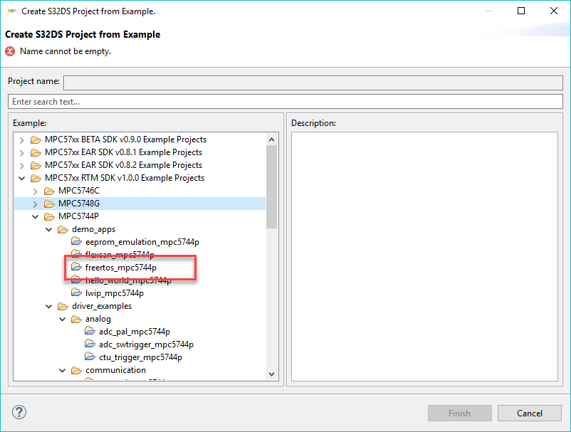

martin_kovar
Hello Jed,
yes, there is FreeRTOS available for MPC5744P and this is part of SDK distributed with S32 Design Studio. Please see the links below:
S32 Design Studio for Power Architecture 2017.R1 (Windows/Linux) released!
S32 Design Studio for Power Architecture 2017.R1 - Update 8 available
There is also example project included, which shows, how to use FreeRTOS, please see the figure below:
Martin
5,110 Views
