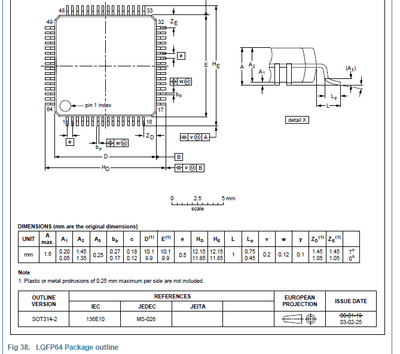

    I plan to use LPC54114J256BD64 (LQFP64 package) in my project and please kindly advise on following questions -
1. For above-mentioned package LQFP64, could please advise if there is any thermal pad (exposed heat spreader) at center location of LPC5411 chipset? It would be great if you can share photo (top and bottom view) of above part.
2. If there is no thermal pad at center location, would it be advisable to place another WLCSP-based chipset underneath LPC54114J256BD64 (LQFP64 package)? In other word, I plan to place LPC54114J256BD64 (LQFP64 package) on PCB top layer and to place another WLCSP-based chipset on PCB bottom layer (directly underneath LPC5411). Any issue with such placement if I have PCB space constraint?

Q1). For above-mentioned package LQFP64, could please advise if there is any thermal pad (exposed heat spreader) at center location of LPC5411 chipset? It would be great if you can share photo (top and bottom view) of above part.
>>>>>As the following LQFP64 package I copied from LPC5411x.pdf, there is not any thermal pad (exposed heat spreader) at center location of LPC5411 chipset.
Q2. If there is no thermal pad at center location, would it be advisable to place another WLCSP-based chipset underneath LPC54114J256BD64 (LQFP64 package)? In other word, I plan to place LPC54114J256BD64 (LQFP64 package) on PCB top layer and to place another WLCSP-based chipset on PCB bottom layer (directly underneath LPC5411). Any issue with such placement if I have PCB space constraint?
>>>>I think it is okay to place another WLCSP-based chipset underneath LPC54114J256BD64 (LQFP64 package) if it is easy for layout, generally, the WLCSP-based chipset is of small package and consume little power.

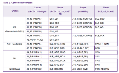

N_com

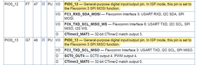

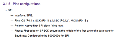

Q1. Refer to chapter 3.1.5 in AN12568, P0.12 is defined as MISO whereas P0.13 is defined as MOSI.
However based on Table 4 (page 12) in LPC5411 datasheet, there is different definition for P0.12  (MOSI) & P0.13 (MISO).
Hence, could please advise which one is correct?
Q2. Refer to Table 2 in AN12568,
       a) P0.13 is connected to SW0 (SPI_S_MISO) and P0.12 is connected to SW1 (SPI_S_MOSI). Is it still valid?
      b) is it correct to assume that BLE_SDO refers to I2S_SO (naming definition as defined in Table18 in NxH3670 product datasheet) whereas BLE_SDI refers to I2S_SI (naming definition as defined in Table18 in NxH3670 product datasheet)?
Thank.

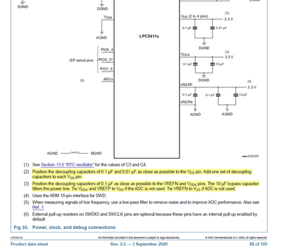

Q4. Below is information (Figure 13.3, page 88) extracted from LCP5411x product datasheet. Refer to note (3), it's advisable to tie VDDA and VREFP to VDD and tie VREFN to VSS if ADC is not used.
Hence, could please advise how should I connect VDDA, VREFP and VREFN if I wish to keep option to use ADC in near future?

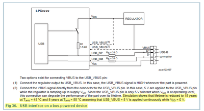

Q5. Refer to Figure 36 (page 92) which I have extracted from LPC5411x product datasheet, there is mentioned of USB_VBUS pin. So far I can find two pins (P1.6 and P1.11) with function as USB_VBUS from pin description (chapter 6.2, page 11).
      a) Do I need to connect VBUS to both pins or either of those pins will do?
      b) Could I use a voltage divider to connect USB_VBUS pin to the VBUS if I plan to it as bus-powered device? And would it help to solve issue of 5V tolerance?

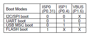

Q7. In page 4 of LPCX5411x_Schematic_B_LPCXpresso54114 board.pdf, there are several boot modes available and P0.4 has been reserved for I2C/SPI boot.
However in AN12568 Table 2, P0.4 has been reserved as BLE_SPIS_SSN. So should it be changed to P0.9 or P0.14 (as recommended in UM10914 page 19)?

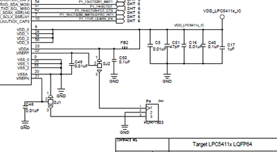

Q8. In page 4 of LPCX5411x_Schematic_B_LPCXpresso54114 board.pdf, there are 4 decoupling capacitors (C5,C51,C16,C40,C17) reserved and shared for all VDD.
However from note (2) in page 88 (LPC5411x product datasheet), it's recommended to place one set of decoupling cap (0.1uF + 0.01uF) to each VDD pin.
So which one is correct implementation?

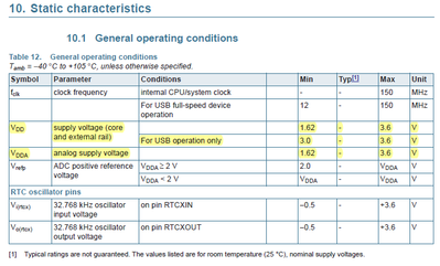

    I've another question regarding supply voltage for LPC5411x -
Q9. , VDD is limited to 3V to 3.6V only for condition "for USB operation only" based on Table 10 as extracted from LPC5411x product datasheet.
What does "for USB operation only" mean in this case? Could please further illustrate?

xiangjun_rong
Hi, Kim,
Regarding the word "for USB operation only", it means if you use USB module, you have to connect the VDD with 3.3V power supply(from 3.0V to 3.6V).
For the crystal device, I think it is okay to use a small package crystal with the same frequency.

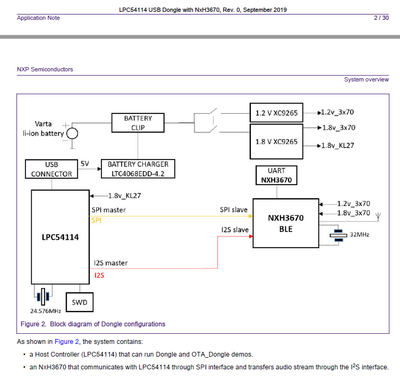

   Thank for replies for Q9 & Q10. How's about Q1 - Q8? Please kindly help to clarify too.
Q9. Refer to Figure 2 in AN12568, LPC54114 is connected to USB connector for audio streaming transfer through I2S interface to NxH3670. However, I noticed that 1.8V_KL27 (instead of 3.3V) is supplied to LPC54114 even though LPC54114 is connected to USB connector.
Could you bplease clarify regarding this issue?

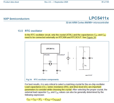

Q10. a. Below is information about selection of crystal that I extracted from LPC5411x product datasheet. I can't find any information regarding CL, RS, and DL. So how I should select a "matching" crystal?
         b. Also, I noticed that the frequency range for crystal is quite wide of which cover 32.768kHz to 25MHz. Any advise how to select correct crystal frequency?
Thank.
3,528 次查看
xiangjun_rong
>>>>>I think you have to follow up the specs in data sheet of LPC54114, connect VDD to 3.3V if you use USB. I am not familiar with  NxH3670, does it require only 1.8V logic?
>>>>The CL,RS and DL are parameters for the crystal, which are from crystal manufacturer. The formula CX1 = CX2 = 2CL -(CPad + CParasitic)  tell you how to compute the CL with external capacitor, pad cap, parasitic cap. The CL is required by crystal manufacturer.
>>>>There are two external clock, one clock is from PIO0_22 pin, it is called CLKIN, the range can be from 1MHz to 25MHz, but it must be clock source rather than crystal. The PLL can use the CLKIN clock as input clock.
>>>>For the RTC crystal(input from RTCXIN and RTCXOUT pins), I think it must be 32.768kHz crystal. The PLL can use the 32.768KHz clock as input clock.
