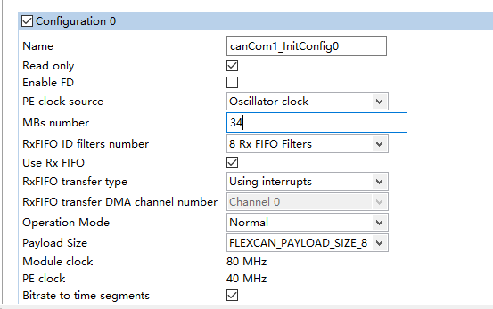

yes, I try to test the FIFO for flexCan,the main scripts are as belows:
 FLEXCAN_DRV_Init(INST_CANCOM1, &canCom1_State, &canCom1_InitConfig0);
  FLEXCAN_DRV_SetRxMaskType(INST_CANCOM1, FLEXCAN_RX_MASK_GLOBAL);
  FLEXCAN_DRV_SetRxFifoGlobalMask(INST_CANCOM1,FLEXCAN_MSG_ID_STD,0x1FFFFFFF);
  FLEXCAN_DRV_ConfigRxFifo(INST_CANCOM1,FLEXCAN_RX_FIFO_ID_FORMAT_A,&can_fifo_config);
while(1)
 FLEXCAN_DRV_RxFifo(INST_CANCOM1,&recvBuff);
but unfortunately, I can't receive CAN messages in recvBuff.is there anything wrong?Do you have any suggestion?picture.PNG
hope your answer,thank you.

PetrS
should below example be helpful?
https://community.nxp.com/docs/DOC-342882
BR, Petr
