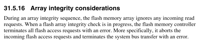

lukaszadrapa
what does it mean that "this function will crash"?
Notice that the FlashArrayIntegrityCheck() function must be executed from RAM. I guess that this could be the reason. From reference manual:
If this doesn't help, let me know and I can create some simple SW example.
Lukas
