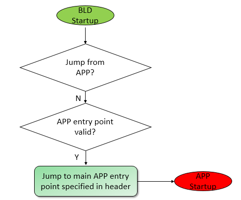

The screenshot shows the flow chart when there are both boot loader code and APP code inside ECU.

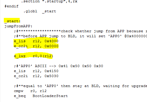

I can see that you read RAM memory right after the startup in bootloader:

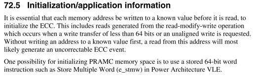

This will work if the RAM is initialized (when SW reset was triggered by application). But it will not work after power-on. You have to check the RGM_FES register to check the source of reset. If it was software reset, you can read the RAM. If not, it will probably lead to ECC error:
I didn't study the files in detail, it's just the first thing I can see. Could you check this?

Thanks a lot.
I try your suggestion: before read RAM value @0x40000000, I check the functional reset bit first. But seems it doesn't work, still stuck in sometimes
