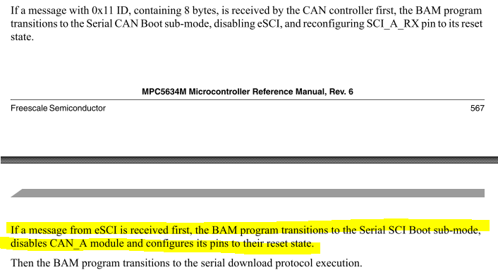

Dear Support Team:
My customer is using MPC5634M BAM module to load their application code into internal flash through CAN bus. Pin129 is used as a GPIO drive some external circuit with a pull-down resistor to ground.
So far everything works fine if the pull-down resistor is 100K Ohm.
However we could not connect to the micro if the pull-down resistor is changed to 10K Ohm.
Since pin129 is multiplexed with NEXUS EVTO function, we are not sure if there is any conflict. And according to datasheet, this function is not available on 176LQFP package.
Could you help to check if extra attention should be paid here?
Your quick response would be highly appreciated!
Wang.

lukaszadrapa
Hi Wang,
do you use auto baud rate detection or not?
EVTO pin is used to disable or enable this feature:
There's internal pull up on this pin. If you use external 100K pull down, then this pull down is not strong enough to override the internal pull up. So, there will be logic '1' and the auto baud rate detection is disabled.
If you use 10K pull down, it will override the internal pull up, so auto baud rate detection will be enabled.
I think that this could be the reason.
Lukas

lukaszadrapa
Even if EVTO function is not available, the pin is still there. I did quick test on my 144pin package and when I add pull up or pull down to this pin, I can see that SIU_RSR[ABR] is changed as expected.
Lukas
