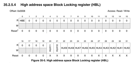

Tell me how to implement the function of removing write protection of the high block in the MPC5646B processor. I took the example with MPC5602B as a basis, but I can only write to the lower part of the flash. How can I implement writing to the second bank of the flash. I am trying to use this code

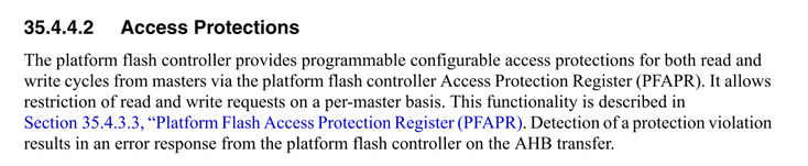

Access protections may be applied on a per-master basis for both reads and writes to support security and privilege mechanisms.

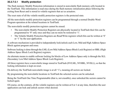

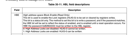

You need to unlock the HBL before programming:
/* unlock HLB block */
CFLASH.HLB.R =  0xB2B22222; /* unlock register */
CFLASH.HLB.R = 0x00000FFF; /* unlock all HLB flash */

I tried changing the password, and when using an incorrect password, I receive error code A00. Now, the password is accepted (no error), but I get error code 200 during flash programming.
