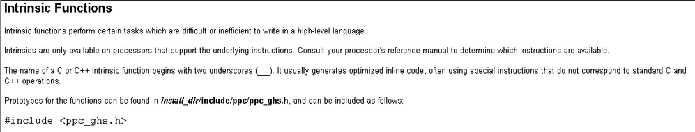

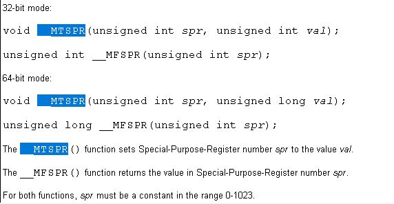

1. Where is the referenced instruction __MSTPR exist?
I noticed an include file I am not familiar with #include <ppc_ghs.h>

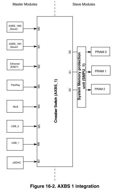

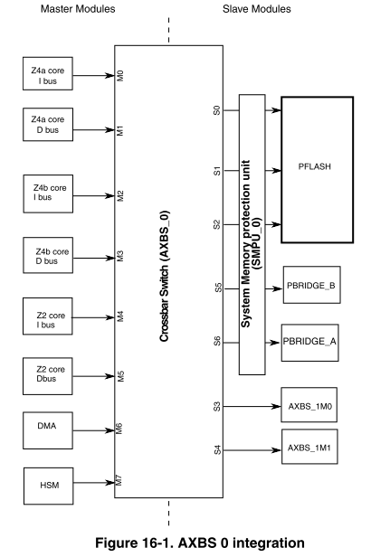

2. In the example, is there a specific reason for switching to SMPU_1? Couldn't SMPU_0.RGD[6]  be used instead?
// Peripheral Address Space (256MB)
SMPU_0.RGD[5].WORD0.R = 0xf0000000; // start address
SMPU_0.RGD[5].WORD1.R = 0xffffffff; // end address
SMPU_0.RGD[5].WORD2.FMT0.R = 0xffc0fc00; // rw set for masters: M0, M1, M2, M3, M4, M8, M9, M10
SMPU_0.RGD[5].WORD3.B.CI = 1; // set cache inhibit
SMPU_0.RGD[5].WORD5.B.VLD = 1; // enable descriptor[7]
// SRAM used by all cores (768kB)
SMPU_1.RGD[0].WORD0.R = 0x40000000; // start address
SMPU_1.RGD[0].WORD1.R = 0x400bffff; // end address
SMPU_1.RGD[0].WORD2.FMT0.R = 0xc3ffff00; // rw set for masters: M0, M3, M4, M5, M6, M7, M8, M9, M10, M11, M12, M13
SMPU_1.RGD[0].WORD5.B.VLD = 1; // enable descriptor[0]

1. From GHS documentation:
If you don't like this style, you can write own functions.
2. SMPU_0 can't cover RAM. RAM can be covered only by SMPU_1. There are two crossbars, so there are also two SMPU modules. From reference manual:
