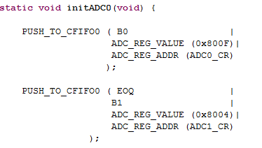

In the configuration of the EQADC in the micro MPC5634 as I can change the resolution of the ADC to 8 bits.
EQADC.CFPR[0].R = 0x80040C00;                        /* Conversion command: convert channel 12--->0C// 16 bits */
EQADC.CFCR[0].R = 0x0410;                            /* with ADC0, set EOQ, and send result to RFIFO 0 */
while (EQADC.FISR[0].B.RFDF != 1){}                           /* Wait for RFIFO 0's Drain Flag to set */
Tps = EQADC.RFPR[0].R;                                        /* ADC result */
TpsMv = (uint32_t)((5000*Tps)/0x3FFC);                   /* ADC result in milivolts */
EQADC.FISR[0].R = 0x10020000;

I change it in Alternate configuration 0x08 but the values I get remain the same as 14 bits as the image.
I have the code as well.
Does not change to 8bit
It is better a resolution of 14 bits as the one I get or 8 bits is for the calculation of the times of injection of a motor

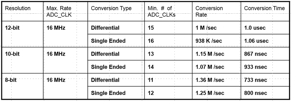

It is needed to mask results as I depicted by red color. otherwise you have just 14-bit result but never 14-bit accuracy.
The only reason for choosing 10/8bit is shorter conversion time by one/two adc cycles.
