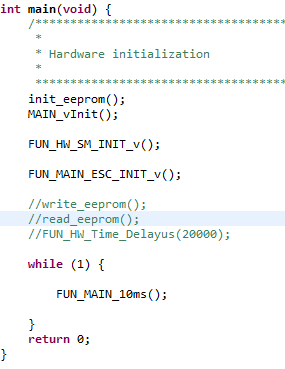

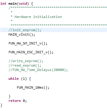

I'm using EEPROM Emulation on MPC5744P. Now I have met a problem.
Before eeprom initialization, I have a program with run time 5ms, but after initialization, I need 14ms-15ms to finish the program. Have you ever met these kind of problems? Could you please give me some suggestions to solve this problem?
Thank you.
This picture is before initialization
This picture is after initialization

lukaszadrapa
it's not clear to me. Do you mean that init_eeprom adds significant delay? You can check the source code, there may be a lot of things to be done. Or do you mean that the execution time of other functions gets longer? In this case, it would require more debugging to find what takes more time. One option is to toggle a pin at beginning and at end of each function (you can use different pins) and check them by scope to find the root cause.
Lukas
