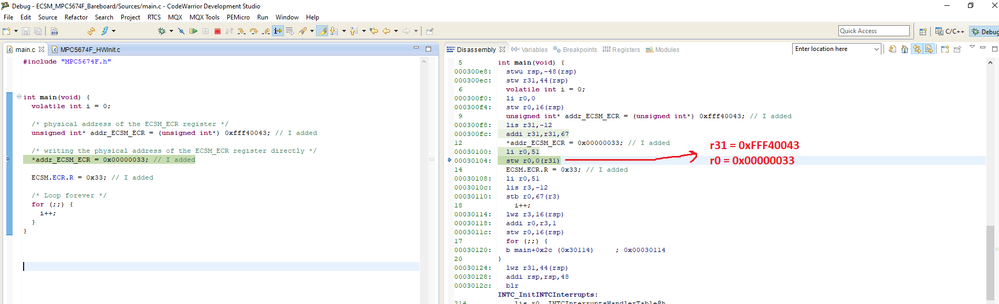

Here how I create the new project in CW for MCU v10.6;
  1. File -> New -> Bareboard Project
  2. I entered a project name,  then click the next button
  3. I selected the Qorivva -> MPC56xxF Family -> MPC5674F and I selected the "Application" as a Project Type/Output. Then click the Next button.
  4. I selected the "P&E USB-ML-PPCNEXUS" as Connection type to be used.
  5. I selected the "C" as langueage, "Use the BookE instruction set" as Instruction Set Options and "SPFP_Only" as Floating Point.
Here what I added to created empty MPC5674F bareboard project;
#include "MPC5674F.h"
int main(void) {
  volatile int i = 0;
  /* physical address of the ECSM_ECR register */
  unsigned int* addr_ECSM_ECR = (unsigned int*) 0xfff40043; // I added
  /* writing the physical adress of the ECSM_ECR register directly */
  *addr_ECSM_ECR = 0x33; // I added
  /* Also I run the below one. */
  ECSM.ECR.R = 0x33; // I added
  /* Loop forever */
  for (;;) {
    i++;
When I built and debugged the project in the RAM,  I couldn't see any changes in physical address of ECSM_ECR register in Memory window and Register window.
When I built and debugged the project in the FLASH, at the part of the writing the physical address of the ECSM_ECR register (when I try to step into at the stw r0, 0(r31)), the code flow goes into IVOR1trap (Machine check).
Here the code and assembly language of it;

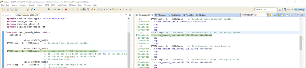

Here, what I came after stepping into the "stw r0, 0(r31)";
Code flow stucking at the IVOR1trap.
I did run at MPC5674F MCU and CodeWarrior for MCU v10.6.

Here is the function that I used to enable ECC reporting.
void initializeECSM(void)
	// Enable Flash 1-bit Reporting
	ECSM.ECR.B.EF1BR = 1;
	// Enable Flash Non-Correctable Reporting
	ECSM.ECR.B.EFNCR = 1;
	// Enable RAM 1-bit Reporting
	ECSM.ECR.B.ER1BR = 1;
	// Enable RAM Non-Correctable Reporting
	ECSM.ECR.B.ERNCR = 1;
Here is the weird values of ECSM registers in the Register Window.
Also the value in the related physical addresses seen in Memory Window and Register Window are not same!
Assembly code for initializeECSM function in MPC5644A and MPC5674F are same and the r0 and r3 values are same.
CAN YOU HELP ME?
Mert.
5,734 次查看
petervlna
The function looks fine to me, however i cant be sure as I do not have your header file.
Either share also address definition of this register in header file, or assembly code.
What you can do is to write whole register at once, not via byte access.
And you can also simply assembly debug the function and see if the core is writing to ECR register and where is the issue.
Peter
