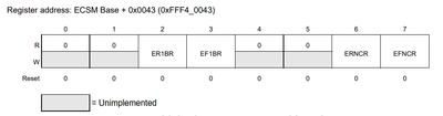

I want to use ECSM module in order to report the correctable and non-correctable bit errors. I am having a problem about setting the ECSM_ECR Register bits. I am writing 1 (one) into the bits, however they are remaining as 0 (zero). I could not figure out why it happens.
Here how I am setting the bits to enable reporting the errors.

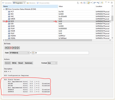

When it stops at the breakpoint, I checked the Register Window of the CodeWarrior 10.6 which is shown in the below. As you can see, the ECR register bits are not set.
Note: I remove breakpoints and tried to run, again ECR register bits are not set. Also, I tried to write 1 to bits by using the Register Window, however still the value of the bits are remain as 0.

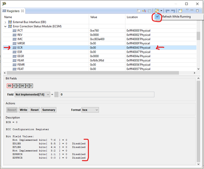

I tried to change the ECSM_ECR values from the Registers Window via PE micro debugger. It didn't work for ECSM_ECR. However, I am able to write to ETPU module and PCR registers via same PE micro debugger.
Try it on erased micro, in case some register protection mechanism is blocking your access.
I assumed that, my other codes in the project may be the cause of the writing problem to ECSM. Therefore, I created a new Bareboard project for MPC5674F and I just wanted to enable RAM and FLASH reporting of ECSM.

When I built and debugged the project in the RAM,  I couldn't see any changes in physical address of ECSM_ECR register in Memory window and Register window.
When I built and debugged the project in the FLASH, at the part of the writing the physical address of the ECSM_ECR register (when I try to step into at the stw r0, 0(r31)), the code flow goes into IVOR1trap (Machine check).
Here the code and assembly language of it;
Here, what I came after stepping into the "stw r0, 0(r31)";
Code flow stucking at the IVOR1trap.

The offset of the ECR Register is 0x0043. Therefore the physical address of the ECSM_ECR register is 0xFFF40043.

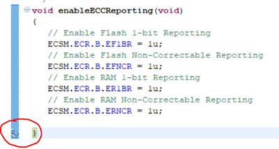

Here is the function that I used to enable ECC reporting.
void enableECCReporting(void)
   // Enable Flash 1-bit Reporting
   ECSM.ECR.B.EF1BR = 1u;
   // Enable Flash Non-Correctable Reporting
   ECSM.ECR.B.EFNCR = 1u;
   // Enable RAM 1-bit Reporting
   ECSM.ECR.B.ER1BR = 1u;
   // Enable RAM Non-Correctable Reporting
   ECSM.ECR.B.ERNCR = 1u;
Also here is the assembly code of the enableECCReporting function. I checked the r0 and r3 values for every stb r0, 67(r3) assembly code and write the values of the r0 and r3 register into the figure.
Until this point, everything looks fine right? However, either memory location of the ECSM_ECR in Memory Window and the ECR register representation in the Variables Window are not changed. Here is the values shown in the Memory Window and Variables Windows for ECR register.

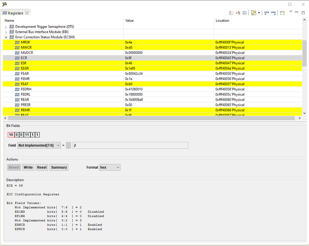

The value of any ECSM module registers are not changing in run-time at MPC5674F. I run the code without breakpoints and monitored the values in the Register Window for ECSM.  However, I couldn't see any changes in the registers.
MCU = MPC5644A
IDE = CodeWarrior for MCU  v10.6
Also, I wanted to check the ECSM module at MPC5644A. I have the nearly same ECSM code for the MPC5644A MCU.
In MPC5644A, the values of the ECR register change strangely. For example, the values of the Unimplenmented part of the ECR register takes value as 1. However, I am not setting them. Also, ER1BR, EF1BR, ERNCR and EFNCR bits takes values 0 and 1 randomly. I am doing anything to change them. Unfortunetly this is not just for ECR register of the ECSM. All ECSM register taking randomly value. However, there is code to do that. It is too strange.

        uint8_t ecsm_reserved0040[3];       /* 0x0040 - 0x0042*/
        union {
            vuint8_t R;
            struct {
                 vuint8_t:2;
				vuint8_t ER1BR:1;
                vuint8_t EF1BR:1;
                 vuint8_t:2;
                vuint8_t ERNCR:1;
                vuint8_t EFNCR:1;
            } B;
        } ECR;                  /* ECC Configuration Register @baseaddress + 0x43 */
void initializeECSM(void)
	ECSM.ECR.B.EF1BR = 1;
	ECSM.ECR.B.EFNCR = 1;
	ECSM.ECR.B.ER1BR = 1;
	ECSM.ECR.B.ERNCR = 1;
Here is the weird values of ECSM registers in the Register Window.
Also the value in the related physical addresses seen in Memory Window and Register Window are not same!
