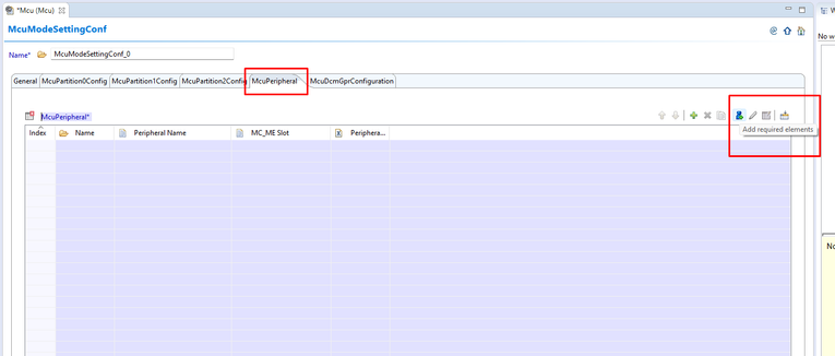

I am getting error in existing sample configuration from MCU module related to MCU peripheral
during generation.
i had use sample plugins of MPC574XG_MCAL4_0_RTM_1_0_5_Sample_Application.
could anyone help me in this.
1 返信
981件の閲覧回数
petervlna

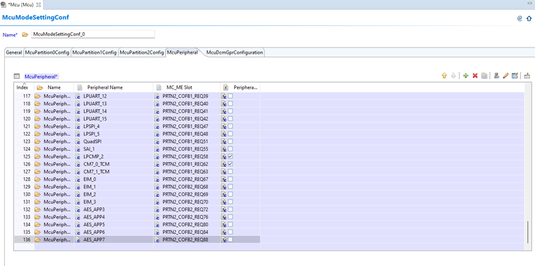

As the error states:
So add McuPeripherals to match the number 66 in MCU module:
Below is the example for S32K3 but the principle is the same for any uC.
