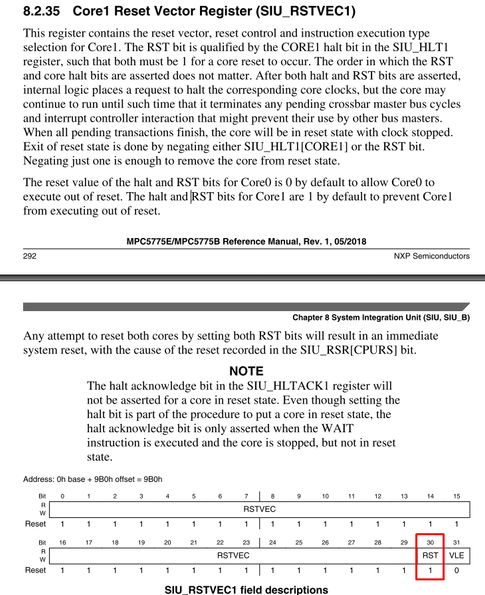

Hii all,
Here are the things what I have done!
Just created multi-core independent projects for MPC5775B in S32DS IDE for two LEDs blinking in two cores. But core0 is getting enabled after flashing the code but not core1 and core1 is getting stated after the manual reset is done or after a power cycle .
Can any one help how to enable core1 along with core0 at time without doing the manual reset.
1,395 Views
petervlna
Hard to say.  Usually the reset is done by SIU from the uC on core enable event.
Have a look at reference example:
https://community.nxp.com/docs/DOC-335462
Peter
1,213 Views
NarsimhaKorra
We have tried with the SIU->RSTVEC1 register, but still it's not working. Need a solution for this. I have attached the project zip here. Please look into it and suggest the required changes.
