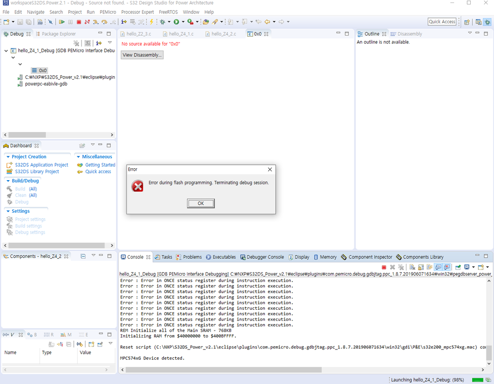

hello, i made one board using circuit of devkit-MPC5748G.
when i use a devkit, it works well in s32ds studio. debug mode, download in devkit are good.
but in my board, something wrong..

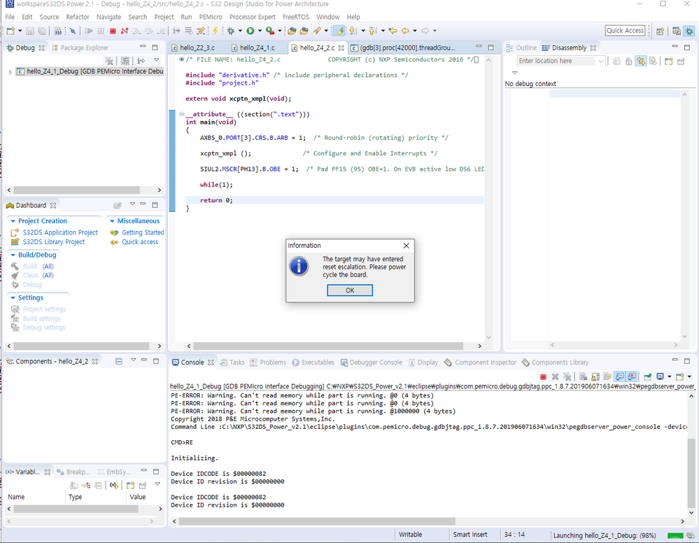

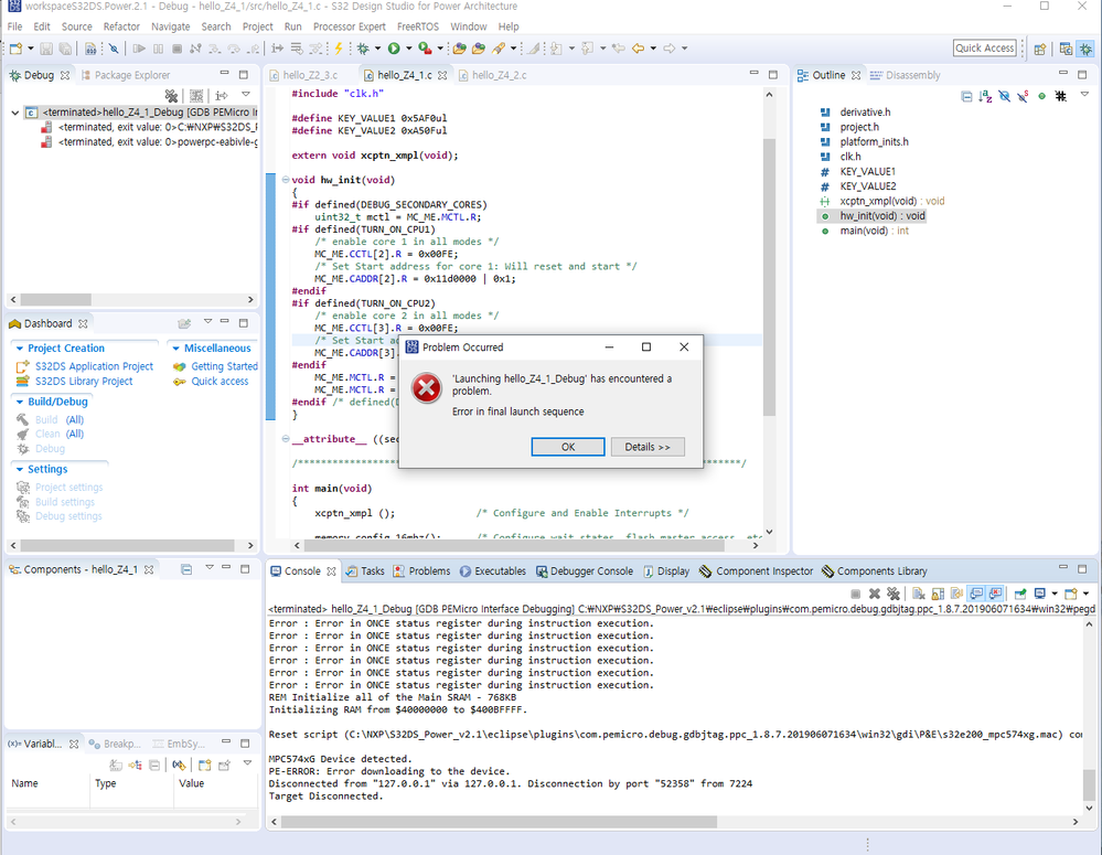

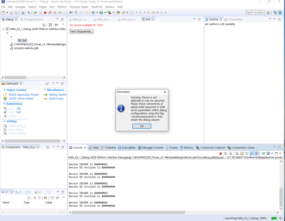

i attached captured pictures of s32ds error..
please help me
here..
Sequential Error Screen
2,472 Views
davidtosenovjan
That's difficult question. Have you get your prototype board ever running? You have installed blank new MCU in your board, correct? Have you measured power sequence and reset signal? D

redginseng
Thanks to you, i found something wrong in reset signal and i realized that reset circuit was wrong.
Thank you !
