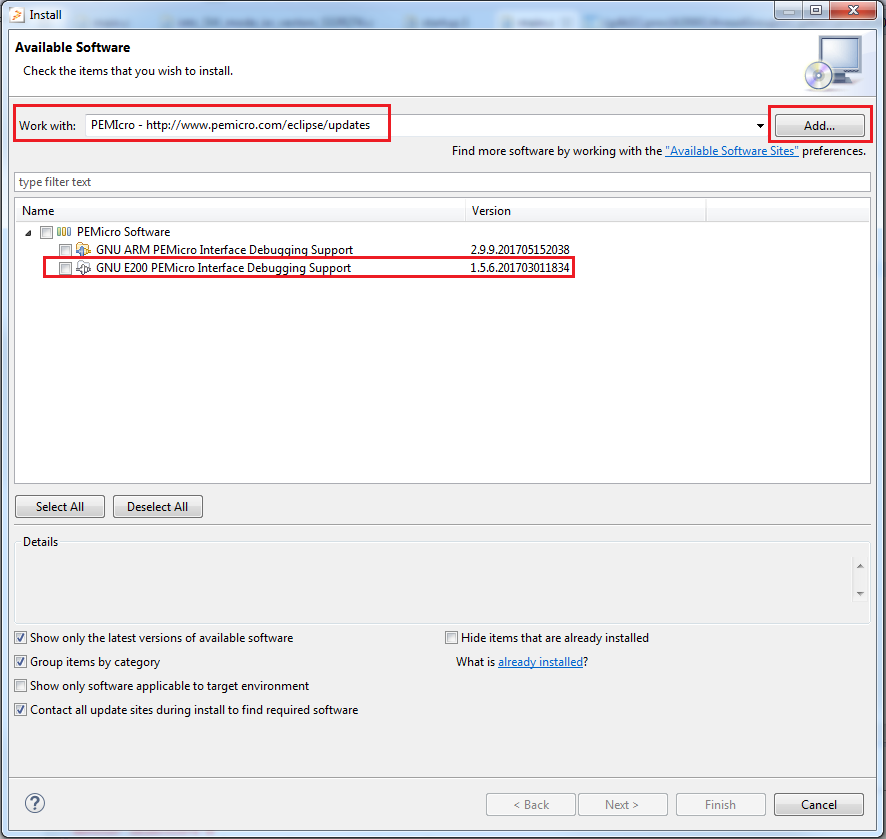

I have connected the PE micro Universal MultiLink Interface. However I tried simple new project without any code.
Debug fails with below error. I tried doing RAM debug also,but it also failed.
Can someone help here

martin_kovar
which version of S32DS you use? In case you use v1.1, have you installed Update1?
S32 Design Studio for Power v1.1 - Update 1 available
What is the microcontroller mask?
Have you updated PEMicro drivers? Also please check, if you have installed GNU E200 PEMicro Interface Debugging Support (see picture below). If you do not see PEmicro in Work with window, click Add button and add address http://www.pemicro.com/eclipse/updates.
I tested with S32DS v1.1 with Update1 installed and it works correct on my side.
