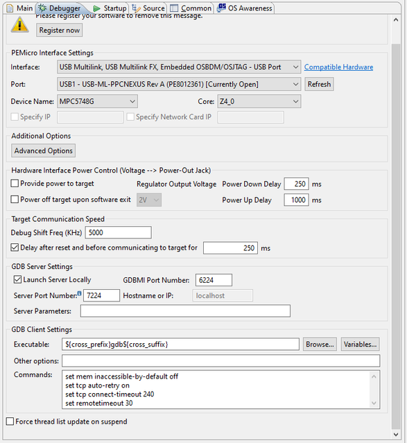

When trying to enter debug mode,warning is show below and RESET (Pin-9) is always driven low(either the red or the yellow LED light up),bug my board can working ok when use OpenSDA;
Any ideas what I could do or check?

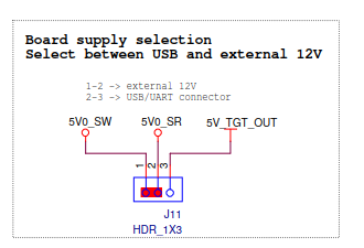

So it works with OpenSDA but doesn't work over JTAG connector, correct?
Have you connected 12V external supply over barrel connector?

Yes, when I use OpenSDA, it works normally, both for debugging and programming, but when I use JTAG, it cannot be programmed and debugged. I have tried both external 12V power supply and USB power supply
5,188 Views
davidtosenovjan
I just checked it here and it works fine. Here is the configuration.

I checked, my configuration is the same as yours, I think my mutilink may be broken.
