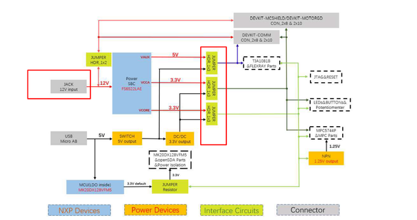

I have a problem to use external 12v.
When I input 12v, then the SB_RSTb indicator is turned on with little noise sound.
I think it's because of wrong connection between pins.
Now i disconnect them, but it was still indicating SB_RSTb.
I need some guide to solve the trouble.
It means your device is held in reset.
Are you able to connect via JTAG?
Did you followed quick start guide?

petervlna
Hmm, reset should be released once stable voltages are provided.
Can you check whether the voltages are in datasheet specified range? Just to be sure you didn't burn the board. There should be no issue if the jumpers are placed correctly.

236
Together, I did powering selection settings(J44,J45,J43) to External 12V Power Supply.
