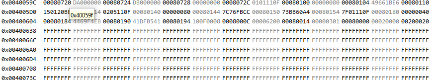

Hi All,
I try to flash DCF record with code from example
C55FMC.LOCK0.R &= 0xFFFFFDFF;
/* Program one page in the mid block */
C55FMC.MCR.B.PGM = 1;
*(unsigned int*)0x400638 = 0x0;
*(unsigned int*)(0x400638+4) = 0x0;
C55FMC.MCR.B.EHV = 1;
while(C55FMC.MCR.B.DONE == 0);
C55FMC.MCR.B.EHV = 0;
C55FMC.MCR.B.PGM = 0;
But it was not success.  Can you help me?
Thank you
Tags (2)
1,466 Views
yuriy_serdyuk
I solved, i need unlock utest memory
C55FMC.LOCK0.TSLOCK=0;
