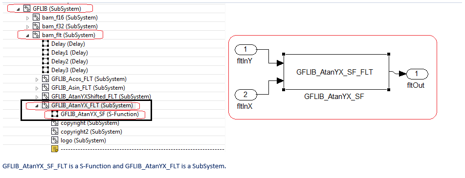

We are using "MPC574xP_AMMCLIB_v1.1.5" (motor control library) in our motor control application. We made a decision to move to Matlab modelling and we intend to use the same motor control library models in our project. But I don't seem to find the right library from the set of library (v1.1.5) that we are using.
For example: In our C code, we use GFLIB_AtanYX_FLT function but I don't see the library model with the same name. Similarly, I don't see the correct model for GMCLIB_SvmStd_FLT function as well.
I am looking for these libraries in "...\nxp\bam\GFLIB\bam_flt" and "...\nxp\bam\GMCLIB\bam_flt".
Can anyone please point me to the right matlab models please?
Following is what I have in those paths related to GFLIB_AtabYX and GMCLIB_SvmStd.

I guess I found the answer:
2,662 Views
sagardhavali
