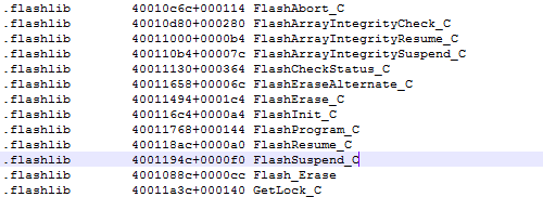

I am using c55 flash libraries  for my controlller s32r274.So inorder to perform flash erase and write
I need to copy flash libraries from ROM to RAM
for this i used linker script using ld file
MEMORY
RAM_FLASHCODE : org = 0x40010400, len = 32K
SECTIONS
/* Flash code load in RAM*/
.flashlib : {} > RAM_FLASHCODE
After compilation i am able to see flash libraries in RAM location.
But after flashing the code to ECU and during test it is not working
During flash init ,the control is moved to RAM,but its not executing.
So i need to know if i need to add some extra code during start up to execute from RAM?

Actually my source code is executing from address 0x00FD0000, and i need to erase sector 0x00FF0000.
   i moved all C55 flash libraries to RAM area and during erase operation flash libraries get executed from RAM area.
      But when i am trying to sector 0x00FF0000,the control goes to exception handlers.
But if i move my application code to sector 0x00FB0000 and try to erase sector 0x00FF0000,It is  working properly.
Can anyone tell me if erase operation cannot be performed if source code is running in same bank.
