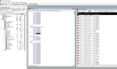

CodeWarrior 5.9 MPC560X Error : Expected operator, got C000 on data section of asmbly language?

lizhichaosdut
For what reason?
thanks!
6 返答(返信)
2,525件の閲覧回数
lizhichaosdut
Prefix 0x is need for CodeWarrior!

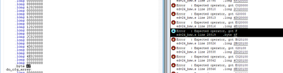

lizhichaosdut
i know .hex number should use prefix 0x
2,543件の閲覧回数
lizhichaosdut
.byte 4F is not OK
2,546件の閲覧回数
lizhichaosdut
change .long to .byte is ok? for what reason?
2,546件の閲覧回数
lizhichaosdut
change the 0080C000 to other number like 00000000 is ok, but it is data section
