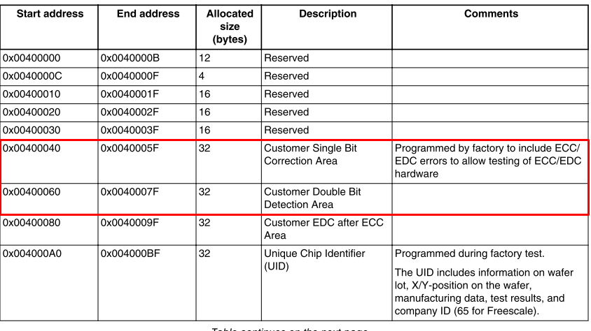

Need your help regarding the check of flash memory ECC failure correct reporting to validate if detected ECC faults are correctly reported.
According to the safety manual,  implementation hint of assumption SM_119 in Rev. 3 06/2014 of  Safety Manual for MPC5744P, this test can be done by reading from the flash Memory UTest area.
However, in the RM no information is available about such test in the UTest area section.

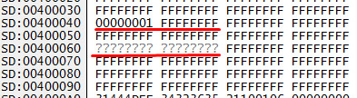

If you look at RM Table 5-6. UTEST flash memory map the information is there. In UTEST area there is from factory programmed signle and double bit ECC error in UTEST flash.
And in debugger:
Read these location to trigger ECC single or double bit error.

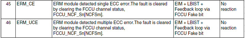

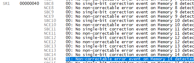

I have a question regarding this topic. I am able to generate the fault in the ERM by reading the UTEST area.
I also have the following init:
// Enable EDC after ECC Error Detection
C55FMC.UT0.B.CPE = 1;
area *utest_ecc_flash = (uint32*)0x00400060;
But I cannot see the FAULT being propagated to the FCCU.
I would expect to see the FCCU status [45] [46].
Is this correct:
Do you have any suggestion?
