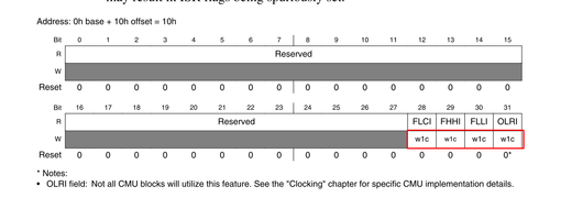

Hi NXP engineers,
I'm using mpc5777c.
jumping to FCCU ISR when SDADC clock is damaged. Interrupt source is CMU. But I cannot clear the FHHI flag. That's why i'm receiveing interrupt continously.
below code is in FCCU interrupt.
what could be the error?
thanks for helps.

Well,not sure what is your issue but I see 2 scenarios:
1. you are not writing 1 to clear the flag. w1c =  write 1 to clear
2. your clock is not correct and as soon as you clear CMU flag, it is set back immediately.
Peter
