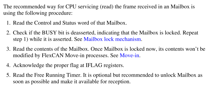

Hi, my name is Xavier.
I have a problem with CAN interruption with MPC5604.
In the first message, i have the interruption, then I read the length of the message , but when i recieve the next message the interruption don´t occur again, only occur when change to another buffer or without reading the length of the message.
I read it with this command:
dummy = CAN_0.BUF[buffer_lectura].CS.B.LENGTH;
This is my code:

the problem is, that when you read the length of the message, you lock message buffer and this remains lock. Please check the the figure below:
I also recommend you to read chapter Mailbox lock mechanism.
If you have any other questions, please feel free to write me back.
