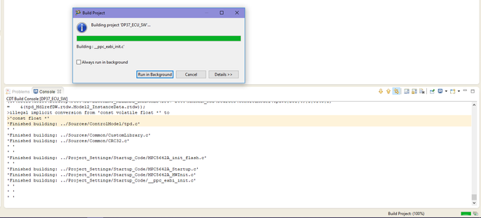

I have a problem that when I first import my source code file to CodeWarrior Dev. St., I clean the project and than build it. However, when I first build the project it stuck in the building process of "Building: MPC5642_init_flash.c". I know it stuck because I wait the process for long minutes to get done but it never does. The pop-up keep still like this:
I always need to "Cancel" the process and build again. And than it completes build process succesfully.
So, it doesn't effect the final situation. But, I don't want to re-build all the time. Any suggestion, please?

If this issue occurs for to specific project only, I'd suspect the project is either corrupted or a project settings has changed.
If I understand the issue correctly this problem occurs just once when you import the project into your workspace. Is that correct?
In which version of CodeWarrior was the project created and which CW version you use to import it?
If it does not help could you possibly post the build output console and the screenshot of output directory?
can you check the makefile and argument files are created in the output directory after first build?
ideally could you e.g. attach the simplified project with just few files to be able to reproduce the issue
I'd suggest you to first try to delete entire output directory and re-import the project.
Hope it helps

If I understand the issue correctly this problem occurs just once when you import the project into your workspace. Is that correct? --> Yes, it is true. When I try to build it again (for 2nd or 3rd time on&on) it gives no error. (no new import, only build) Only first import.
In which version of CodeWarrior was the project created and which CW version you use to import it? --> The project created on version 10.6 and I use the same version to import it.

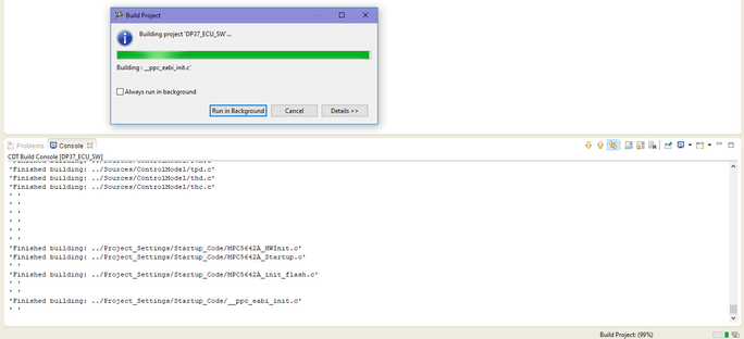

If it does not help could you possibly post the build output console and the screenshot of output directory? -->
(It stuck on different source files this time.) First import and then tried to clean and build:
Second import and then tried to clean and build:

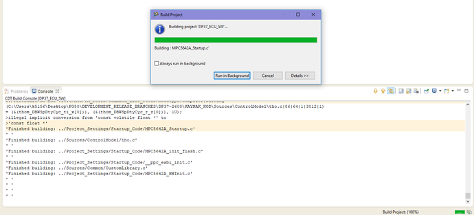

Succesfull import and build process with no error:
Last try import again:
can you check the makefile and argument files are created in the output directory after first build? --> Yes, they are created.
ideally could you e.g. attach the simplified project with just few files to be able to reproduce the issue --> Couldnt simplify the project to produce same error, sorry.
