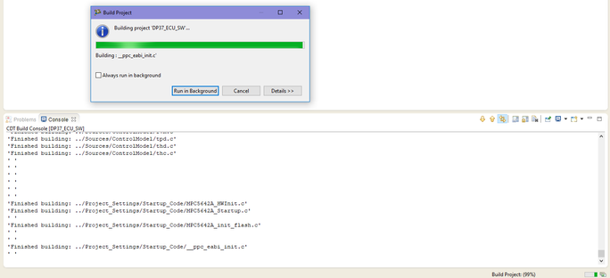

I have a problem that when I first import my source code file to CodeWarrior Dev. St., I clean the project and than build it. However, when I first build the project it stuck in the building process of "Building: MPC5642_init_flash.c". I know it stuck because I wait the process for long minutes to get done but it never does. The pop-up keep still like this:
I always need to "Cancel" the process and build again. And than it completes build process succesfully.
So, it doesn't effect the final situation. But, I don't want to re-build all the time. Any suggestion, please?

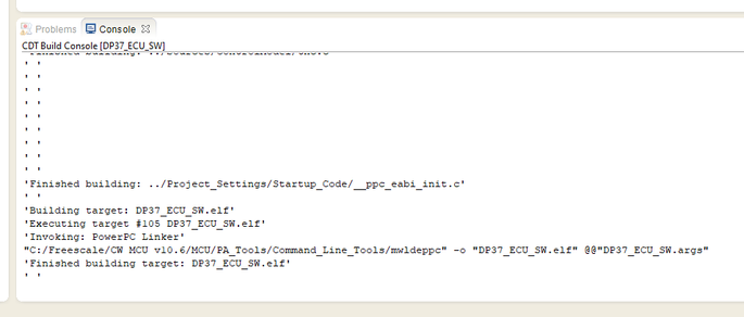

oznurcaliskan
Hi Stan,
Thank you for your help.
If I understand the issue correctly this problem occurs just once when you import the project into your workspace. Is that correct? --> Yes, it is true. When I try to build it again (for 2nd or 3rd time on&on) it gives no error. (no new import, only build) Only first import.
In which version of CodeWarrior was the project created and which CW version you use to import it? --> The project created on version 10.6 and I use the same version to import it.
If it does not help could you possibly post the build output console and the screenshot of output directory? -->
(It stuck on different source files this time.) First import and then tried to clean and build:
Second import and then tried to clean and build:
Succesfull import and build process with no error:
Last try import again:
