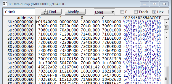

I am using MPC5777C for my application. I am trying to setup my Bootloader to be in location 0x0000 0000 with corresponding RCHW; bootloader then will jump to application if valid.
While using Lauterbach I can run bootloader in such location but after Power On/Reset, the uC is not going to _start of the Bootloader. The rest of the Flash is empty so there is only one place for RCHW
How can I configure the uC to jum to 0x0000 0000 after a reset is made.
P.S. I tried the same excercisewith an Applciation code that starts at 0x0080 0000 with a valid RCHW at that location and it works, but not the location 0x00000000.
Any ideas?
Thanks!

The BAM is working, the reason for failure is an ECC error for uninitialized SRAM area.
