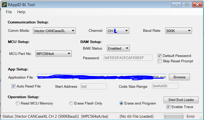

I am having problems to flash over CAN using BAM.
Below is the error message I get from the RAppID gui:
Error message
"Loss Communication with BAM at Password. Check that Password is correct."
"Password Verification failure"
"Initialization
Error with BAM. Check Password or Verify Boot Configuration Setting
ABS2=1, ABS0=0, FAB=1, Please cycle power and try again."
Our code works normally when flashed over a "universal programmer" (debugging), but we need to be able to flash over CAN (CANCase XL).

lukaszadrapa
you can't enable the BAM by software. ABS2, ABS0 and FAB pins or BOOTCFG pins (depends on device) must be configured on hardware level - it is necessary to tie the pins to required voltage level. The state of these pins is read during reset, so they cannot be set by software.
