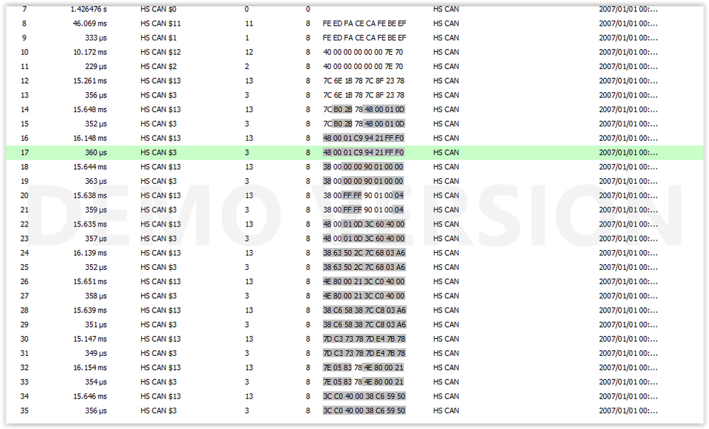

Now I have not IVOR6 exception , I can send the program with j_link and works ,  but after the code download with BAM the application does not run . Do you have any Idea?  attched you will find the first start CAN handshaking , the protocol works and the file I'm pretty sure is continuos...
thanks in advance.

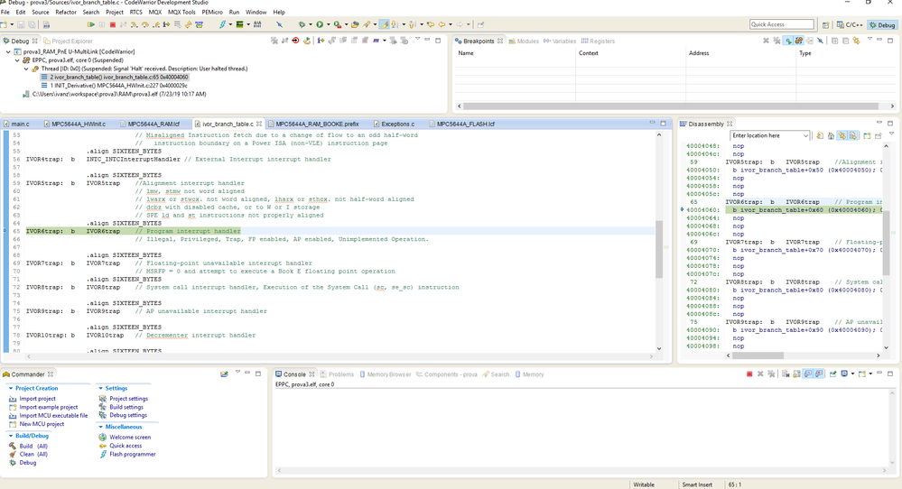

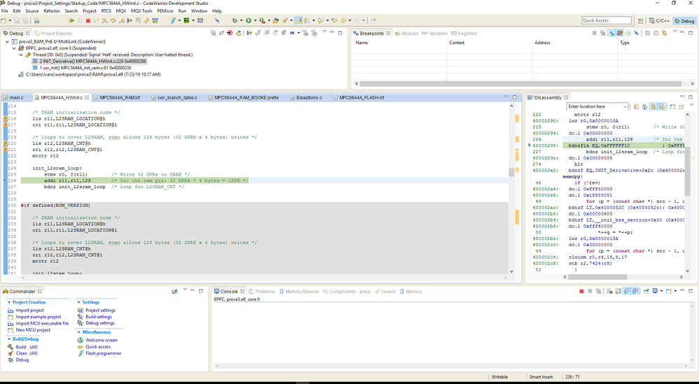

As you can see in the attached image sram_init.png the code pass through the sram init but if I suspend program is in IVOR6 . Do you have any Idea ?
3,270 Views
lukaszadrapa
Are you sure you are not overwriting own code in RAM? What is the value of L2SRAM_LOCATION? If IVOR6 is triggered, this could be the reason. As I wrote before, check SRR0 register and then corresponding address in RAM memory. You will see if it is overwritten or not.
Lukas

lukaszadrapa
this would require some debugging... First step - if IVOR1 is triggered, what is the content of MCSRR0 and MCSR registers? MCSRR0 contains address of instruction which caused the exception and MCSR reflects source of the exception.
Lukas
