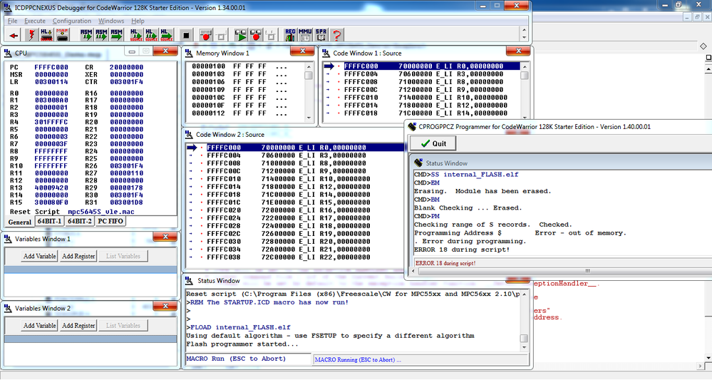

1. We have successfully compiled the demo code and tried to flash the same in MPC5645S-DEMO-V2 EVK.  We are getting an out of memory error while flashing. Please suggest an alternative.

sreedevi_mohan
Hi Lukas,
1. We have used the exact code shared by you [CW_MPC5645S_Demo.zip] and added the access path from the libraries [MPC56xxSLibsV2_0R46.zip].
2. Debug logs means debug prints. We didn't get any processor expert for MPC5645S series.
8,649 Views
lukaszadrapa
There's newer fixed pcp flash algorithm file. However, I can see that it requires new version of flash programmer. I need to check if it is possible to update it in the CodeWarrior. I need to check this with another team. I'm afraid it will take a couple of days due to summer vacations.
Lukas
8,649 Views
lukaszadrapa
Could you try this patch?
http://www.pemicro.com/fixedlinks/CW210_patch_Qorivva_b200624.zip
Follow instructions in readme file.
Lukas

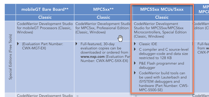

1.We have tried to port the MPC56xxSLibsV2_0R46.zip lab tutorials(tried for LAB 0 tutorial) for MPC5645S in CW by making a new project for the same and integrated the remaining files.But showing out of memory error even though we have compiled successfully. The template for MPC56065S is not compiling successfully.Could you please share a template for MPC5645S project which having graphics libraries ?
2. We got a OVG_PPC_demo.zip code and  successfully displayed a TIGER.bmp image on screen. We were able to check the image library generation using the freescale image encoder tool shared by you and generated .c, .h files for a sample image This is the only working code for MPC5645S we have which doesn't seem to be using Image Encoder tool to generate image(tiger image displayed on screen) library files. We have tried to integrated the MPC56xxSLibsV2_0R46.zip lab tutorials in this project and changed the memory allocations in lcf files ,still no progress.Any idea ?
3. Does the CW 2.10 trial version is having size limit for compilation and flashing? sometimes we are getting error like "demonstration version : too many lines in source code"  is showing.

lukaszadrapa
1. Unfortunately I do not have such example.
2.  I will try to ask around if anybody could help, not sure what the problem is.
3. Free version is limited to 128KB:
https://www.nxp.com/docs/en/fact-sheet/950-00437.pdf
