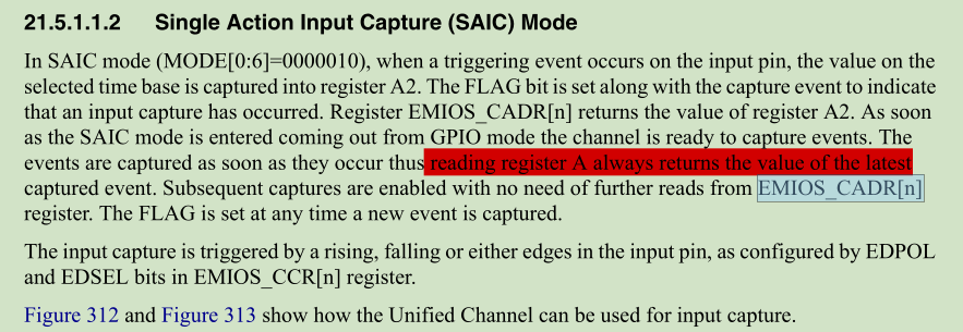

翔宇童
but the emios[2] have SAIC(Single Action Input Capture)MODE ,this mode could return EMIOS_CADR[n]. But I cannot read the change of EMIOS_CADR[n]. How to exlplain it?
