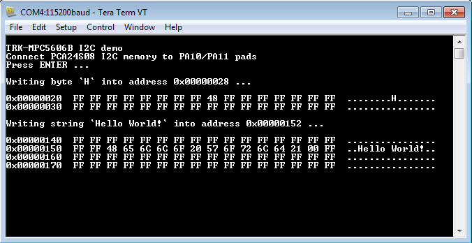

This example shows I2C communication with NXP PCA24S08 memory.
The simple MPC5xxx I2C driver is used,
see driver code/description on https://community.freescale.com/docs/DOC-330972.
EVB connection:
P1.11 - A[10] .. I2C0 SDA
P1.12 - A[11] .. I2C0 SCL
Test HW:  TRK-MPC5606B
Maskset:  0N13E
Target :  RAM, Flash
Terminal: 115200, 8N1
Fsys:     64 MHz PLL with 8 MHz crystal reference in RUN0.
PC terminal displays this info ...

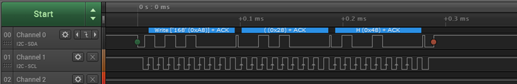

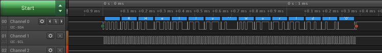

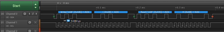

You can see following I2C bus signals for particular conditions …
Writing byte “H” into address 0x28
Read content of the address 0x28
Writing string “Hello world!” into address 0x152
Reading page (16 bytes) from memory address 0x150
