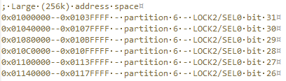

Lukas,
In the "MPC5748G-Flash_RW-GHS614\source\main.c" file I see the bit settings for LOCK/SEL for Flash blocks on MPC5748G.
Shouldn't the Large blocks be using SEL2 instead of SEL0 ?
thanks
Anoop
Hi Anoop,
thanks for your comment. You are right, that's copy-paste issue. I uploaded corrected version.
Lukas

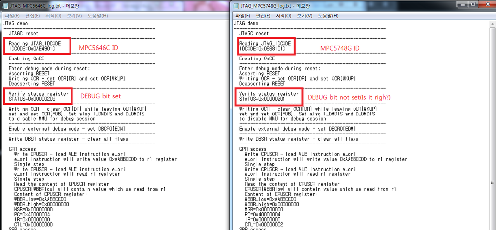

Is it right?
