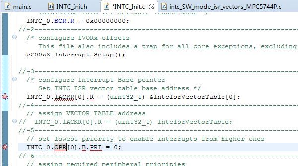

Hello, I want to use your example into S32DS, but some errors occurs.
As is shown in the following picture:
after I put your INTC_Init.c file to the source, two errors occurs.
What should I do to solve the problem?
check the header file to know how the INTC registers are defined.
But, if you create new project through the S32DS Project Wizzard, then is is enough to call xcptn_xmpl (); and add ISR routine into vector table of the intc_SW_mode_isr_vectors_MPC5744P.c file. The  xcptn_xmpl (); is defined in MPC57xx__Interrupt_Init.c.
BR, Petr
The error has not occured. Thank you.
