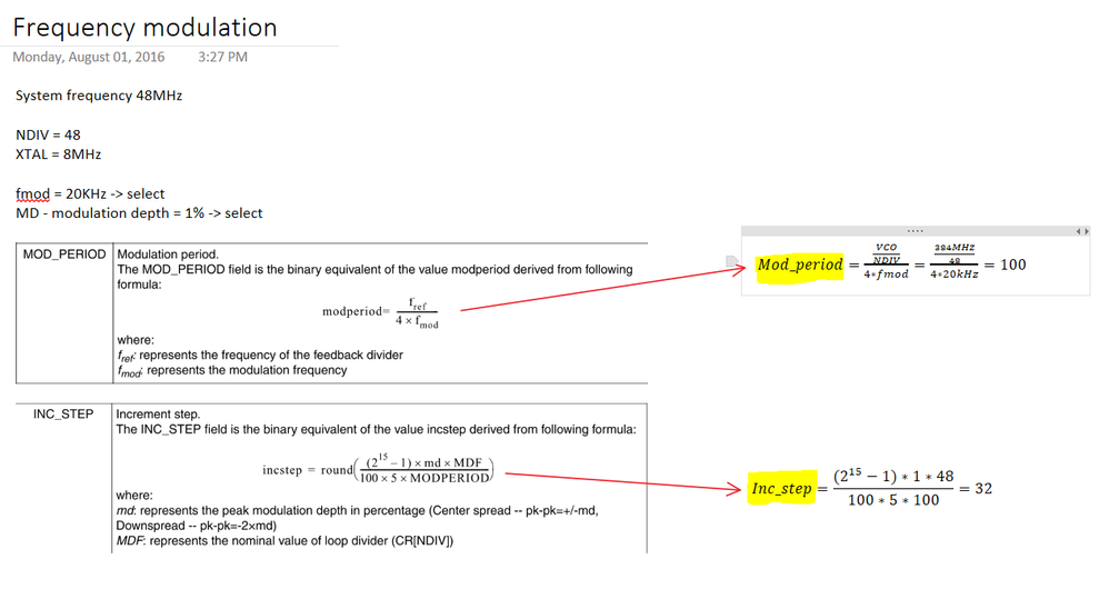

* Detailed Description:
* Application performs basic initialization, setup PLL to maximum allowed frequency (48MHz)
* Setup SIU, and demonstrate frequency modulation.
* Test HW:        XPC560B 64LQFP, XPC56XX EVB MOTHEBOARD Rev.C
* MCU:             SPC5602D
* Cut:               1M18Y
* Fsys:             48 MHz
* Debugger:     Lauterbach Trace32
* Target:           internal_FLASH
* EVB clkout pin : Port J7 - pin 0
