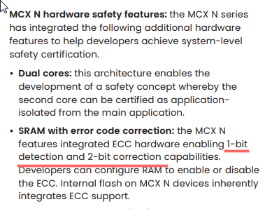

In White Paper MCX N94x, it says that have ECC function "SED-DEC".
How to implement this function?

Hello @wen-lianglin
From refer to MCXNx4x RM:
https://www.nxp.com/webapp/sps/download/preDownload.jsp?render=true
There is a register control enable/disable RAM ECC:
RAM ECC Enable Control (ECC_ENABLE_CTRL
