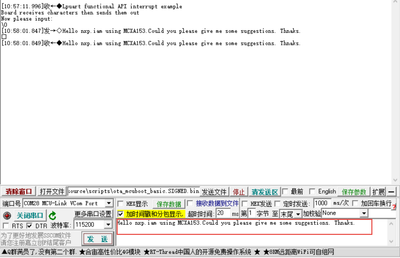

Hello, iam using MCXA153 board , how can i read 20byte of data and how much byte i read in this?

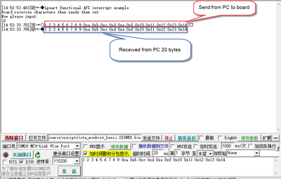

Hello @syedhashmiraza
Please use the accurate demo "Lpuart_interrupt" without any modification. If there is still a problem, please record a video demonstrating all your steps. Thanks.

syedhashmiraza
hello, when iam using printf they recieved only 5 byte my question is using printf i want to read 20 byte

syedhashmiraza
hello , i take 115200 baud rate in this  buad rate printing only 4 byte when i change my baud rate to 300 its printing 20 byte value but my question is  i want to read and print 20 byte value using 115200 baud rate  and this is my code
I still recommend that you use the UART SDK demo. If you still prefer to use your own code, please attach the entire project, which should be directly run on the MCUXpresso IDE. I will help you check it. Thank you.
I have tested this demo on my side, it can received any number of bytes.
In this example, one lpuart instance connect to PC, the board will send back all characters that PC send to the board. So you just need send 20 bytes on PC, then it can received them and send back to PC. I tested with 20 bytes, result as below:
Alice
Sorry could you please describe your requirements detail.
Do you want me send characters not number to test? If yes, I tested on my side. It also can work well. As below.
The Lpuart_interrupt demo can exactly meet your requirements.
Alice
