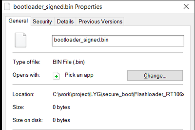

Our product board use imxrt1061. There are two parts in our firmware running on RT1061, bootloader and app.The firmware is saved on extern QSPI Nor flash.We want to use HAB to secure the bootloader.But I cannot generate signed binary file from bootloader.elf using elftosb.Attached zip file is the bootloader.efl and bd file.The bd file is the same as the one in fold Flashloader_RT106x_1.0_GA\Tools\bd_file\imx10xx.The command execution is as below:
c:\work\project\LYG\secure_boot\Flashloader_RT106x_1.0_GA\Tools\elftosb\win>elftosb -f imx -V -d -c imx-flexspinor-normal-signed.bd -o bootloader_signed.bin bootloader.elf

3,135 Views
goodboy2024
Hi Sam,
Thanks for your reply.In my environment,elftosb can work but no effective output.The size of bootloader_signed.bin is 0.My elftosb version is also 4.0.0.
Can you check your output in your side?

1. Normal Boottable Image: elftosb  -f  imx  -V  -c  xxx.bd  -o  xx_signed.bin  xxx.elf
2. Generate SB file for FlexSPI NOR Image encryption
3. Generate SB file for FlexSPI NAND image programming
4. ....
For this issue, it may cause by some incorrect keys(keys/SRK_1_2_3_4_table.bin) which can be found in xxx.bd files.
More details, please refer to this post: https://community.nxp.com/t5/i-MX-RT-Crossover-MCUs/elftosb-command-file/m-p/844844
